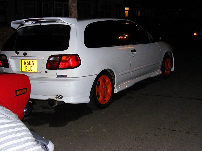

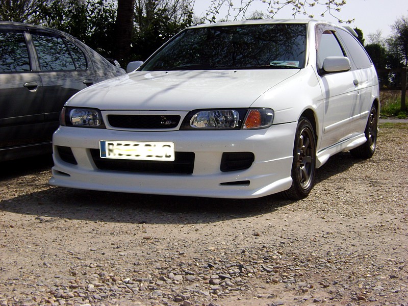

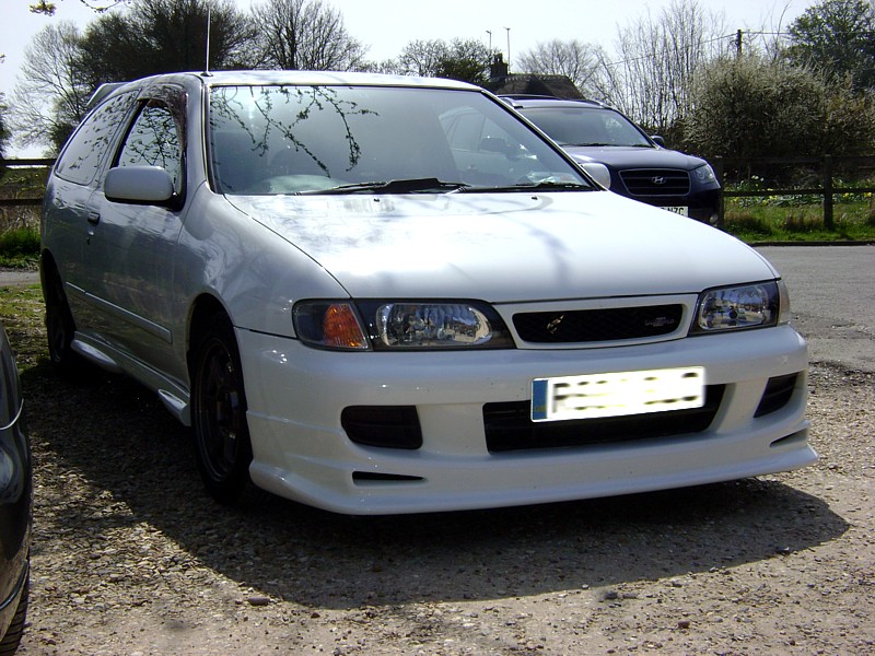

not content with sticking a 20VE in the Primera, got myself a VZR last year, and now have just added to the collection, gone and got myself a VZR N1...
imported it a month or two ago, only just got it registered a couple of weeks ago as well...
comes with
Nismo suspension
Momo steering wheel
B&M short shifter
5Zigen catback
ecu has had a remap with daughterboard installed, not sure on power output at present, will get it dyno'd and mapped properly.

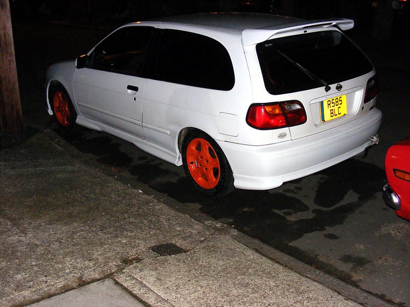

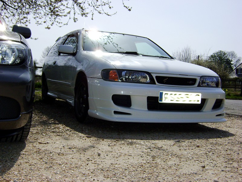

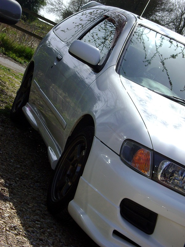

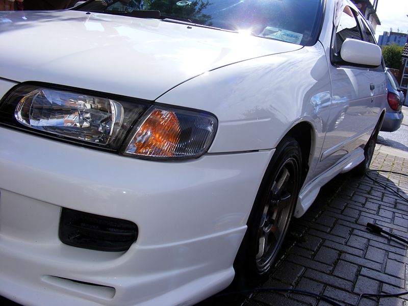

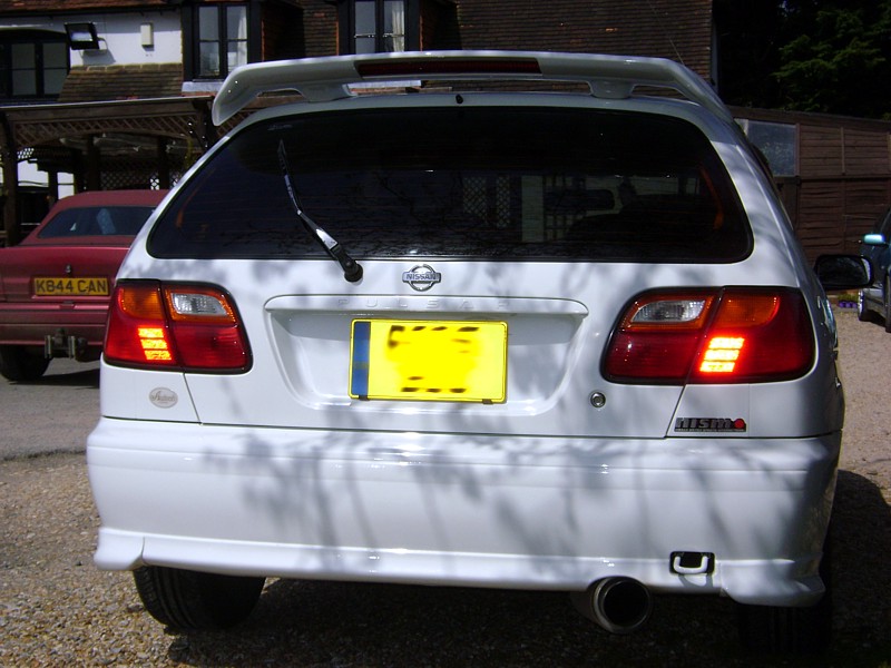

here are some pics...
quite a noticeable difference over the VZR in performance..

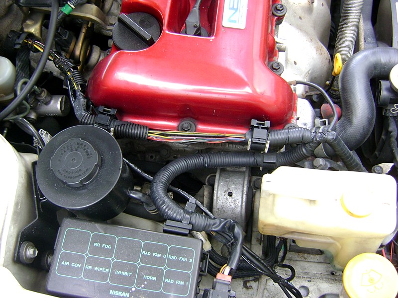

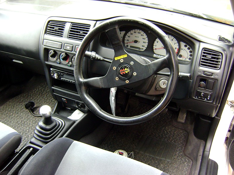

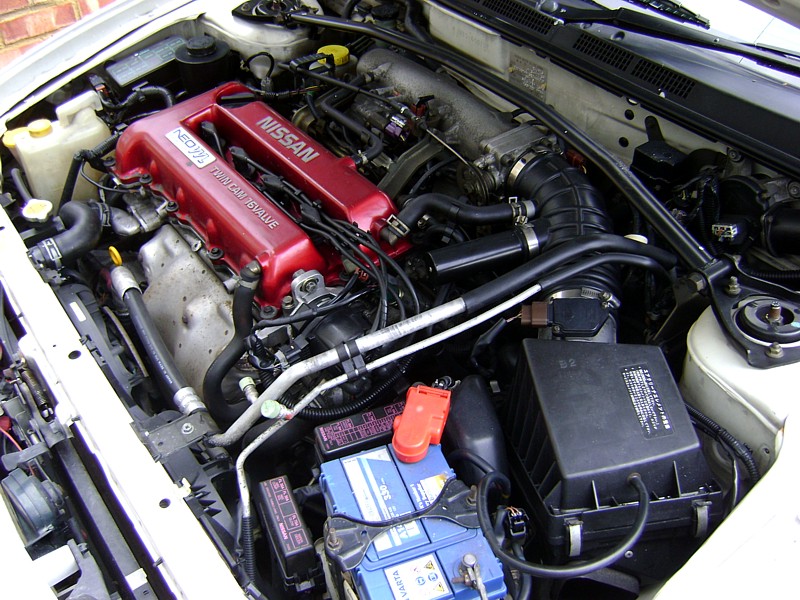

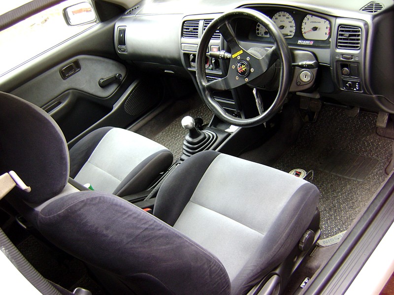

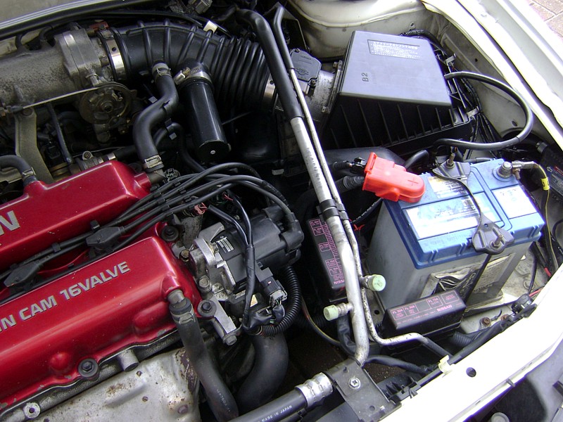

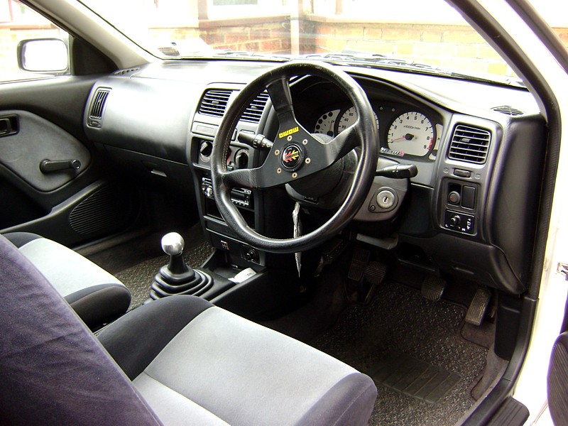

interior and engine bay...
really loving this car, is a proper animal, for a 1.6ltr car it is just amazing.

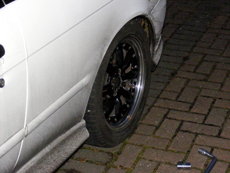

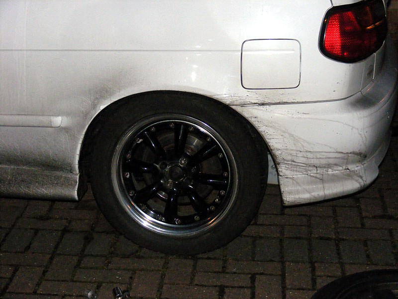

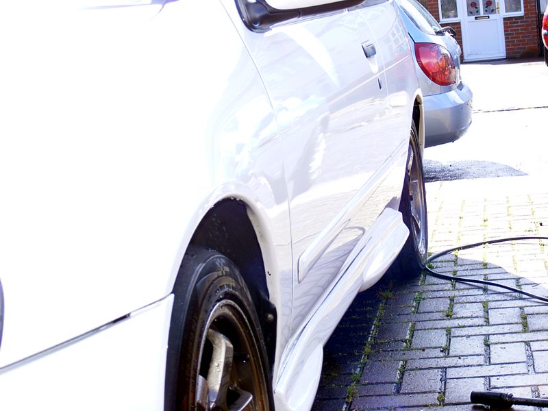

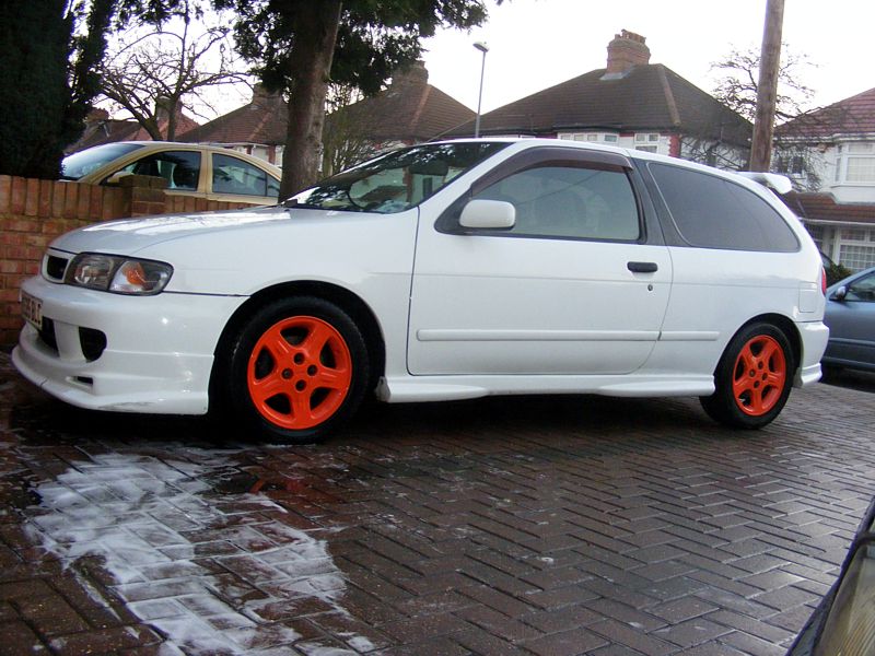

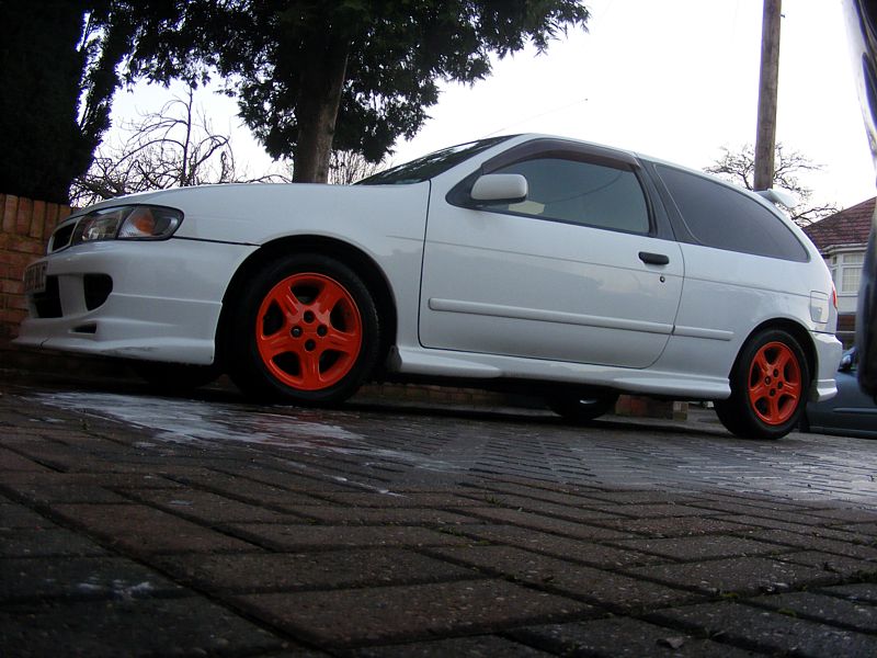

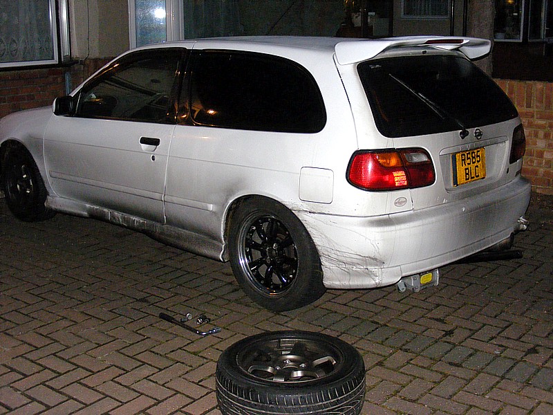

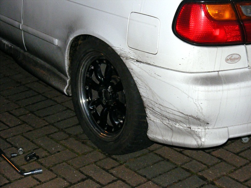

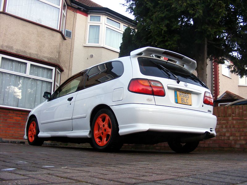

was trying some jdm stylee wheels , didn't go for them in the end...
16" x 7 +38 offset, JDM split rims.. Make think it is Speed Star? RS-8 model.
if I do get em, colour change is also a big option don't think I am keen on the middle bit remaining black..
whatcha all think? any tips opinions?

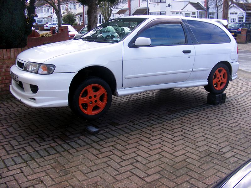

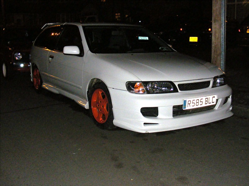

went tango with standard wheels, with winter rubber on them

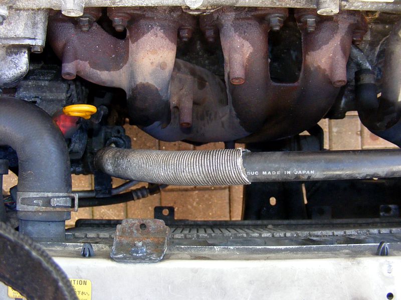

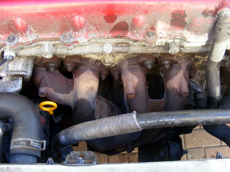

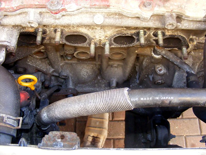

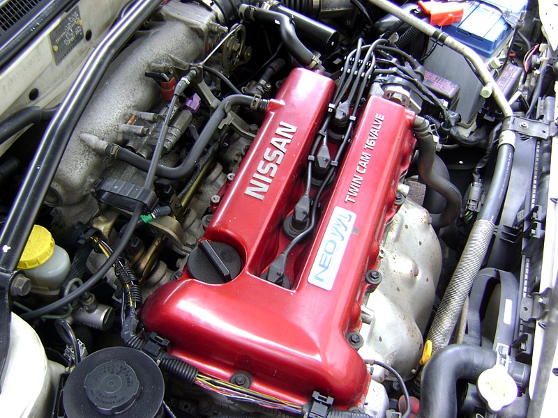

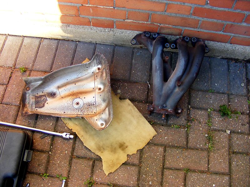

time to get some much needed work done, whilst I started on changing manifold...
time to get manifold off
old one off still need to sort out gaskets and as sump had to come off, not fitted replacement yet

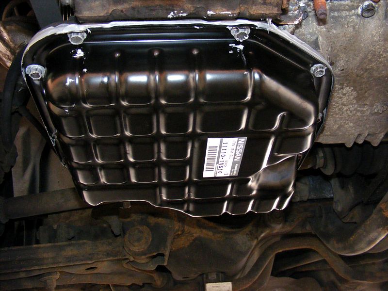

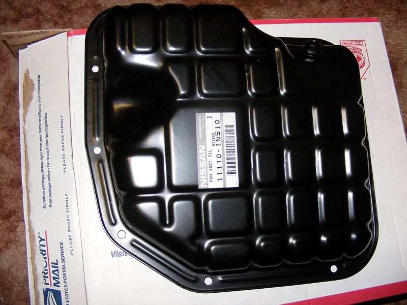

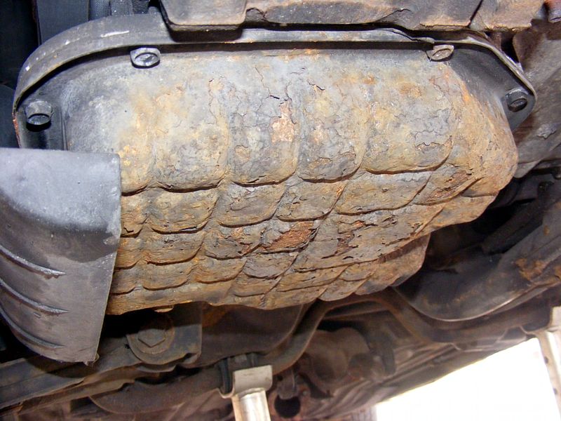

spankly new sump
rusty old sump...time to whip that off
new sump on..

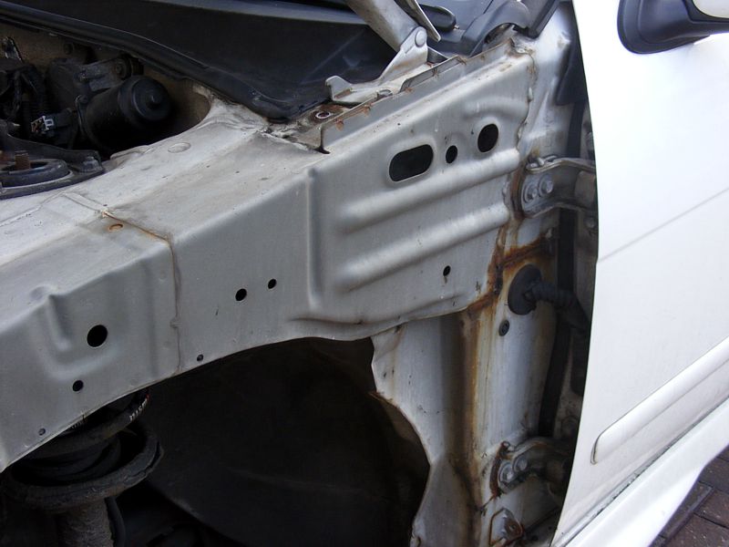

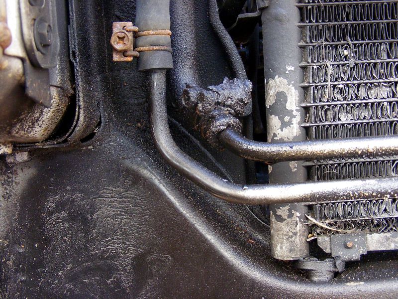

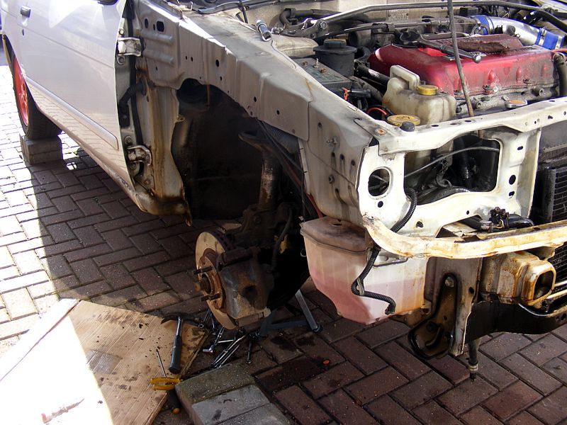

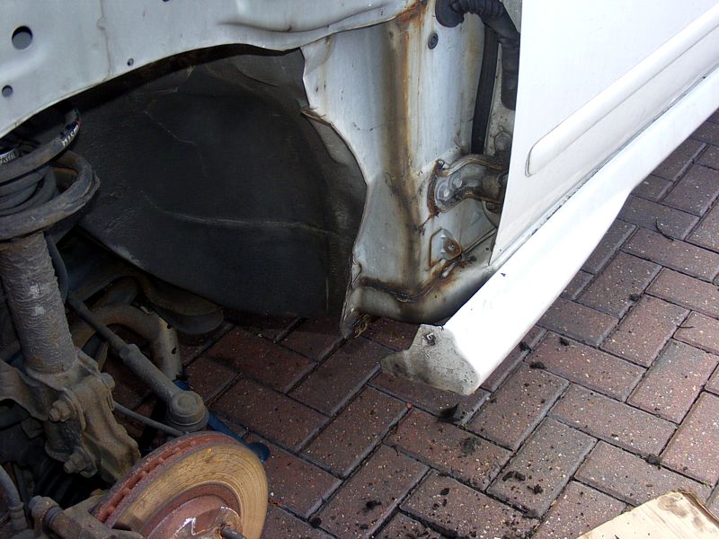

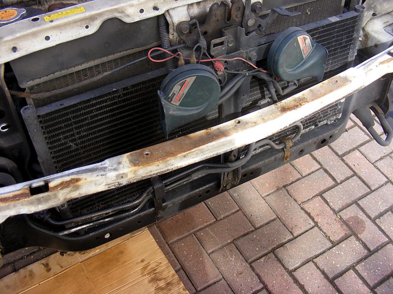

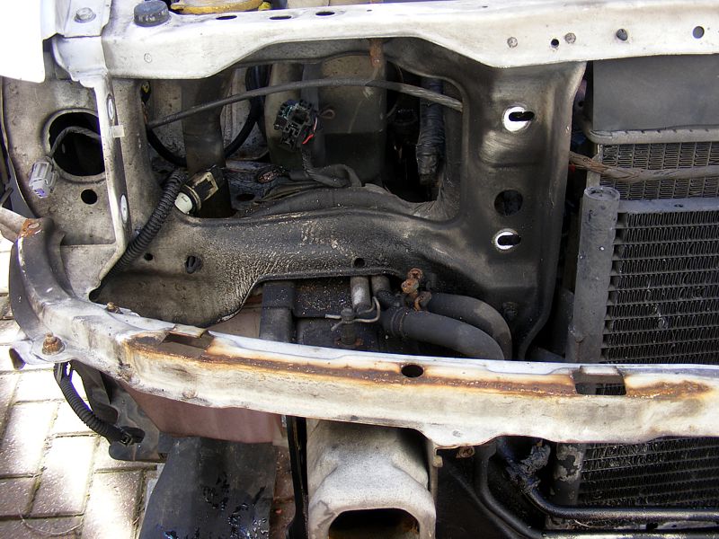

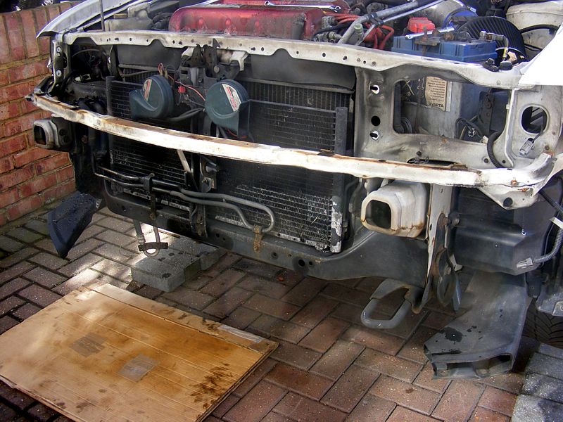

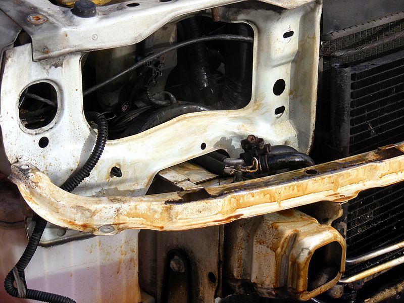

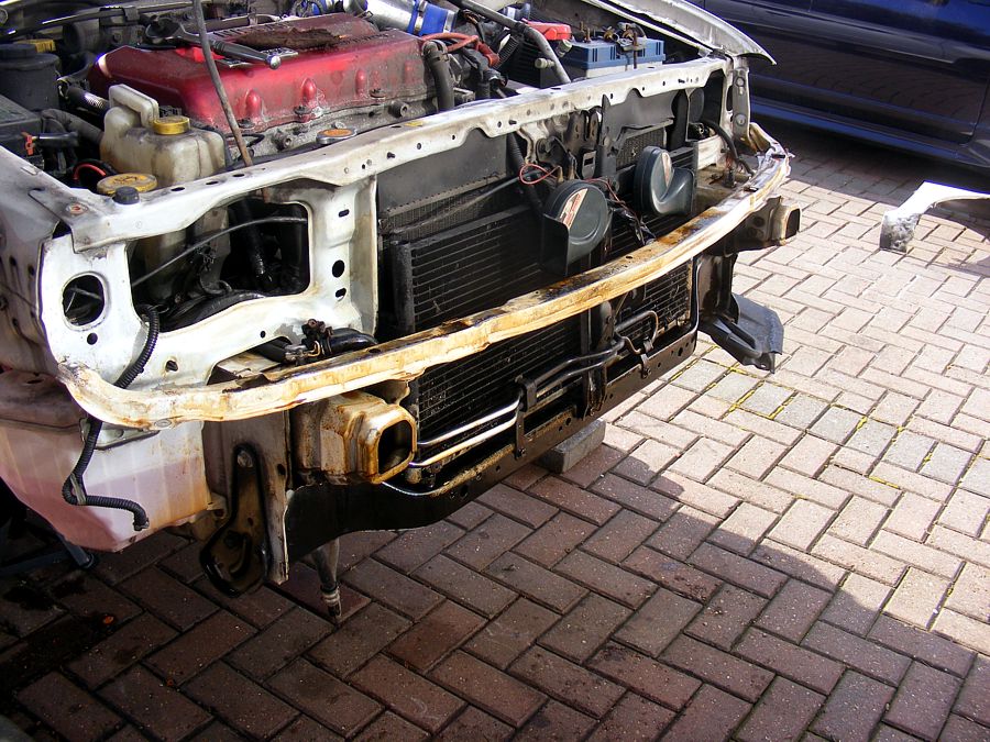

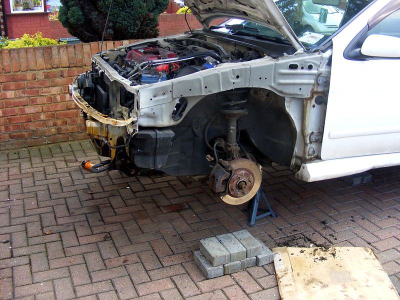

removed the bumper to find the bar it sits on is rusty and so decided to go mad remove a few more things to sort rust
always wondered where the slight oily residue from under the car on drivers side was from, found the culprit..
wings off
any recommendations on what rust protection paint to use?
plan for tomorrow is to remove front suspension and also to remove wishbone, arbs etc to polybush as much of the front end as I can from the Kit I got a wee while ago lol
Good timing changing the sump. It wouldn't have lasted much longer. I use bitumen paint with a 1/4 mix of fresh engine oil as an old school underseal. Seems to be effective.
I got the sump a last year, but it was near the end of year, and since then either not had a weekend free, or with crappy weather had no chance to do anything
I used Black Hammerite behind the lights and on the Headlamp support bar and under the front wings. It's worked on my gate for 6 years so should be ok on the car. Then I used under seal on the cross member and inside the arches.
