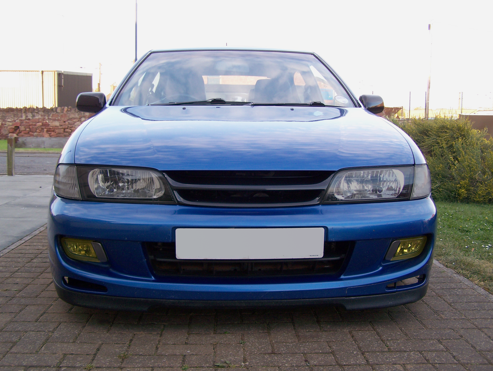

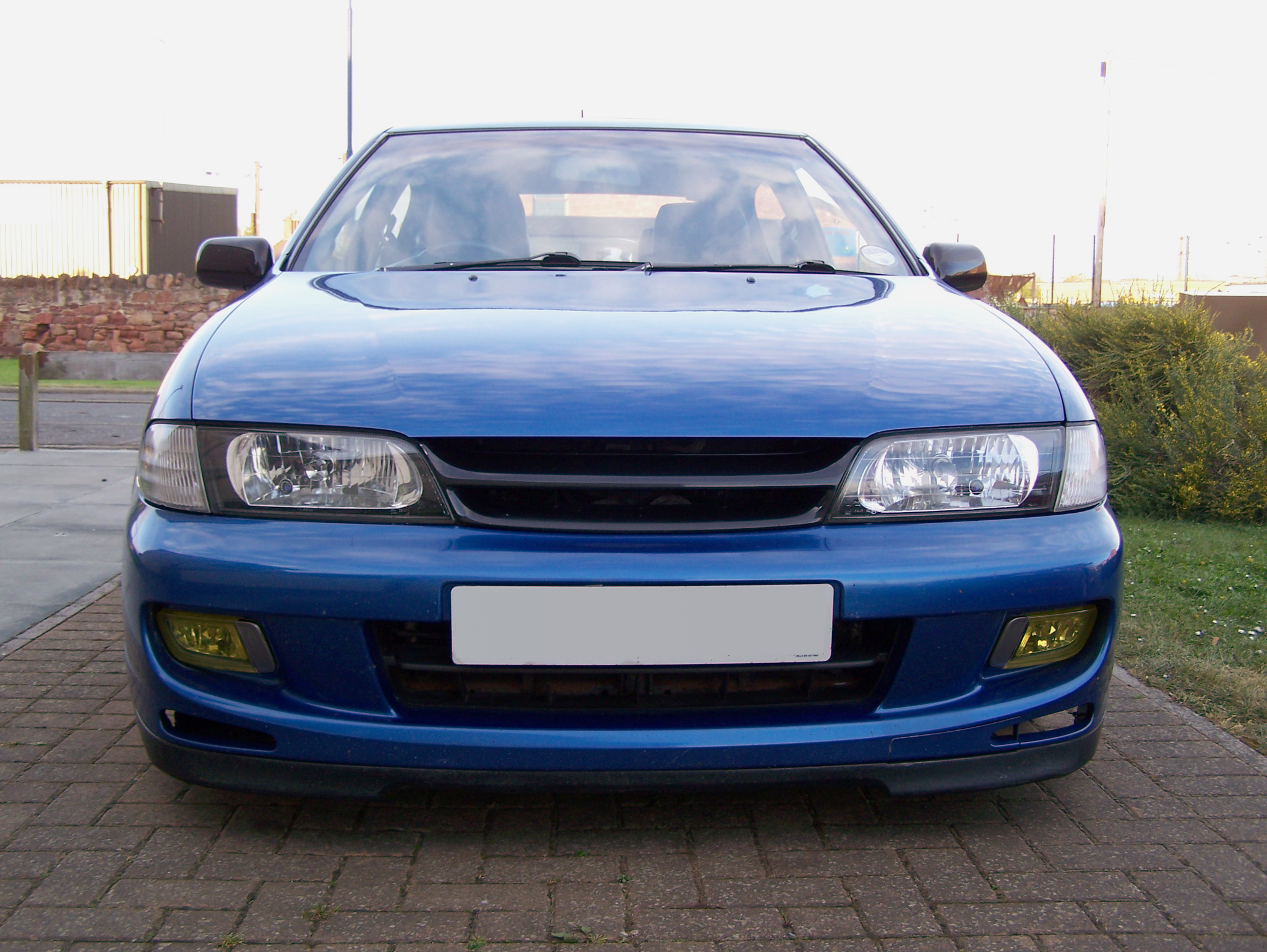

Tinted fogs with Lamin-x protective film..
..went on really easily and seems good quality. Now to decide if I like that look and if so if I want to tint the headlight and indicators too..
light smoke..
..or yellow..
Thanks. The temptation to fiddle is too great, though!
The stuff just peels off so all I have to lose by experimenting is money.
I think the all yellow is too much but think a band of dark betwen the bumper and bonnet would help the aggressive look I'm going for.
Looking at the lines of the lights maybe dark headlights and yellow indicators could work. Hmmm. Think I'll break out the Gimp one last time tonight.
