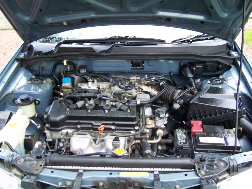

Cleaned out the manky engine-bay today ( a first for me) - not a patch on some of the show-cars members have here but a vast improvement on how it looked having spend 6-years with no-one even looking at it.
An hour well spent I think..
[click to embiggen]
'Gunk' degreaser foam then bumper restorer/polish on the black plastic, metal polish on the metal and tyre restorer/conditioner on the rubber hoses (all with microfibre cloths, of course). Just followed the instructions from the car cleaning site in the links section as I've never done it before.

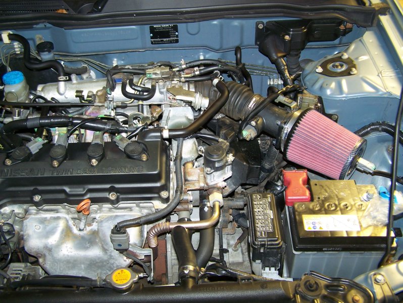

My K&N 57i induction kit (finally) arrived today..
(click to make big)
Only took about half-an-hour to fit as I didn't bother fitting the rubber scoop for the cool air feed as I didn't like where it was supposed to be positioned and didn't want to strip off the splash-guards behind the bumper - it should be fine where it is for now.

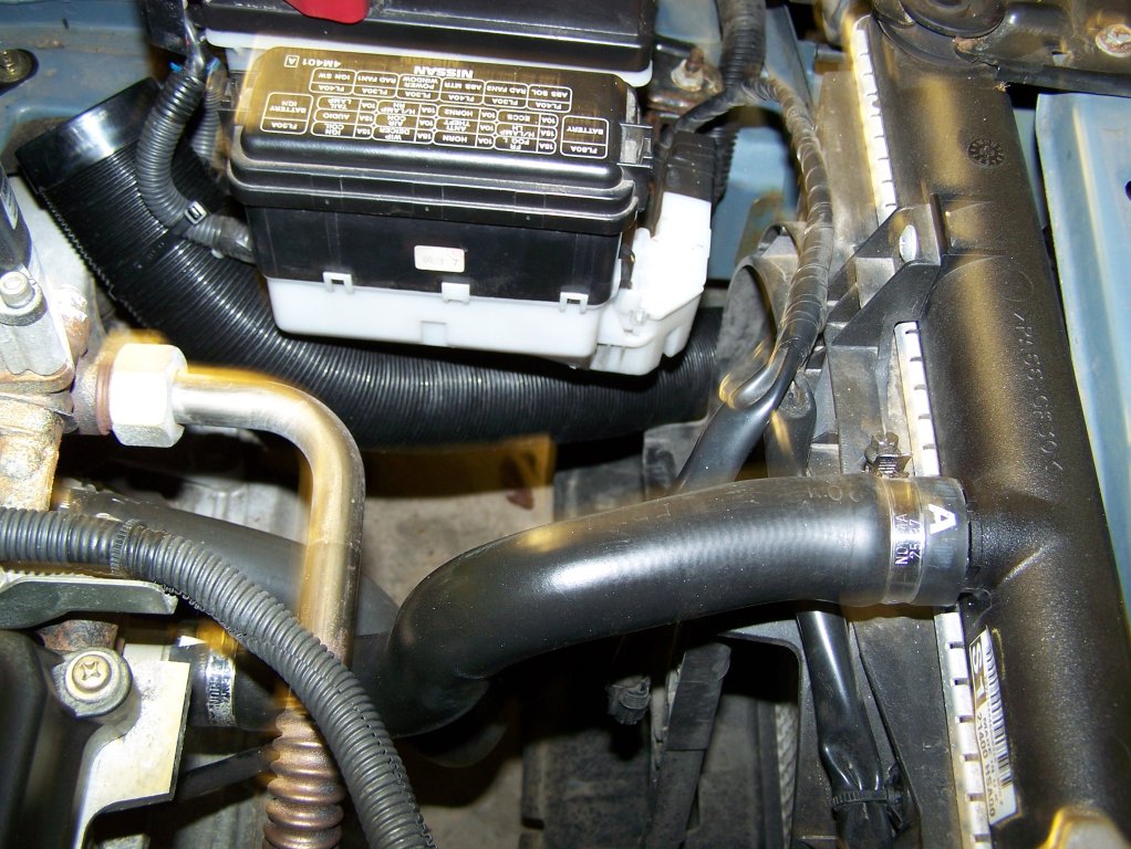

Can you post a pic of where you routed the feed pipe please, as I want to put mine there, but it`s too short, as the only way I can see is going through the hole where the resonance box was & round the bumper mounting bracket, there`s obviously another way, but it maybe different between the P1 & P2.
Not a great pics but best I could get.

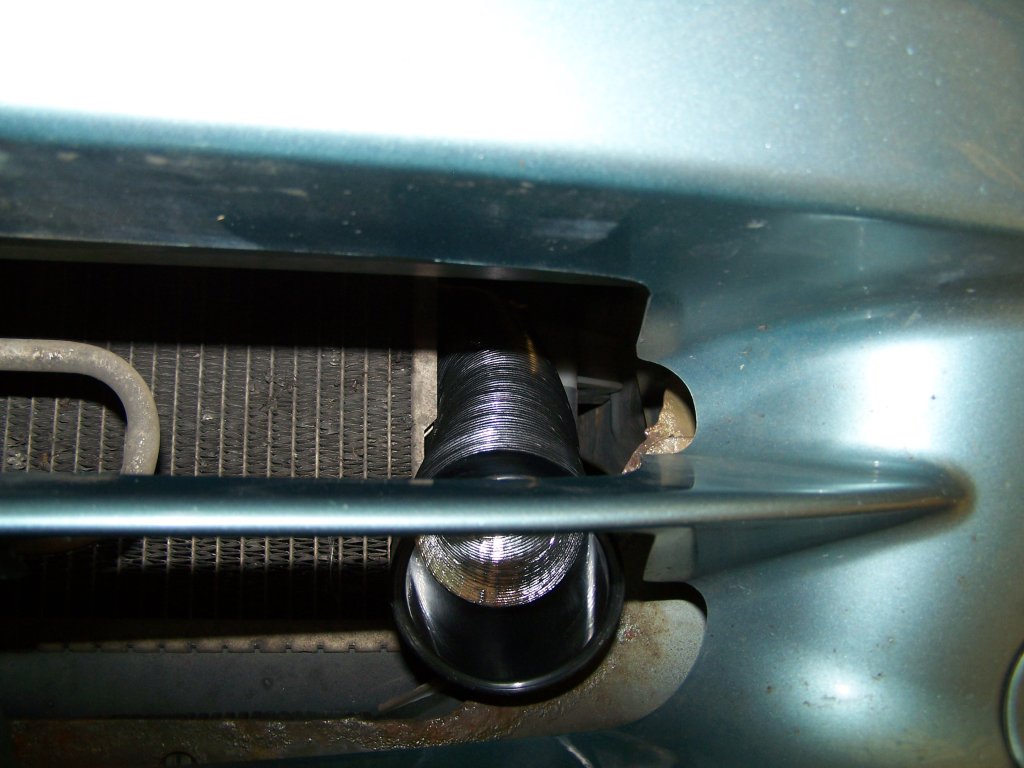

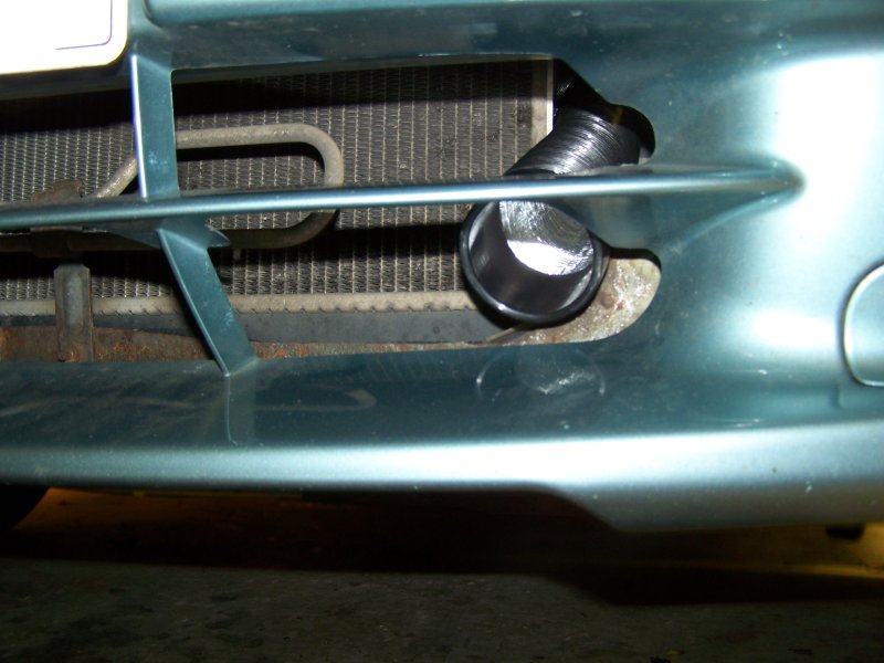

I ran it under the fuse box then between the radiator and headlight cable ducting. It's a damn fiddle to get it through the tiny gap there, had to squish the plastic end cap almost flat to get it through then gently squish the pipe and feed it through until the end reached the inside of the front spoiler then unsquish it all again. At least the ducting pipe is a lot stronger than the stuff I bought for my last car that fell apart when squished. Tie-wraped the top end to the battery and fuse-box cable ducts, the bottom end sits in place nicely as the pipe is quite stiff.
Don't know what diameter pipe you got with your kit but mine was quite narrow, only about 40-45mm? Probably not much use to be honest, especially under 70mph although the spoiler should direct air into it a bit - it'll do for now, I'm not expecting much gain with a standard exhaust, the kit's more to even out the acceleration at low gears and revs (seemed to work with my last car), improve the boring stock engine sound a bit and give me something to do on my day off (blew that as I fitted it faster than I thought I would).
Thanks for that, it`s exactly the same on mine (pipe`s the same size too).
Didn`t want to even attempt to squish it through the gap, in case it broke, but as I said, the easiest way is through the resonance box hole & round the bracket, but it`s at least a foot too short, so thought about making my own from plastic drain pipe. :lol:
