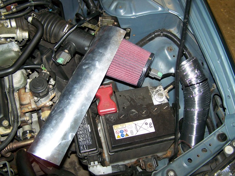

Cleaned and re-oiled my K&N, put it back in and bodged a basic, temporary heat-shield for it. Can't really see in the pic but it's just a 10x13" bit of thin aluminum curled-over at the top and is held in place by sandwiching it between the MAF housing and the K&N fitting (obviously with holes for air-flow and bolts). Doesn't look great but seems to work ok. The 45mm cold air feed from under the radiator runs under it nicely.

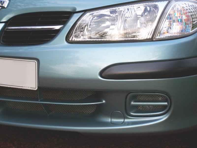

45mm is a bit weedy for a cold-air feed so I also removed my resonator box and ran a 65mm cold air feed from the front-right foglight hole. Looked really rough exposed so I built a vent/grille for it from the blanking piece.
Made another dummy vent for the other side to balance things up.
Got a load of mesh left and want to fill in the big gaps under the bumper to hide the rusty crossmember and 45mm cold air feed but ran out of weld-in-a-tube and time. Guess that's next weekend's job. :rolleyes:
(edit: job done and pic updated)
Click to Enlarge (just like Viagra spam promises!)
ps. If anyone knows why I keep getting that powdery white crap round the battery -ve terminal let me know!
That white stuff is the terminal corroding. if you poor boiling water over the terminal, the white stuff will deslove. then lightly cover the terminal with grease. that should stop it happening again. :)
Ps. you can also get spray tins from halfrauds, which are specially made for protecting battery terminals, but what i said above is just as good imo.
