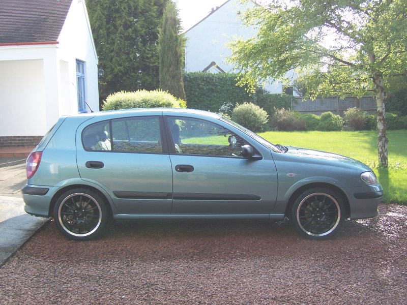

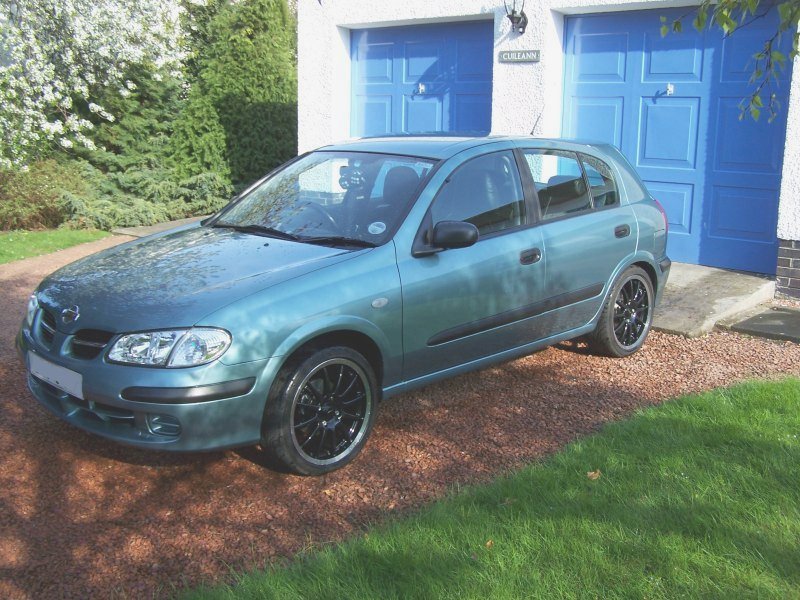

Finally got new wheels..
[clicky biggy]
17" Team Dynamics Pro Race 1.2 with Federal Supersteel 205/40/17 tyres.
This version of the wheels was a test run for the Matt Neil limited edition - they are exactly the same but don't have 'team dynamics racing' embossed on the rim and cost a hell of a lot less.
They weigh the same as my stock 15" steelies with 185/65/15 tyres (about 17.5kg).
Bought from Rochford Tyres - £500 inc tyres, delivery, standard and locking nuts.
Next step - lowering and new brake disks all round.
:respect: Now that looks abso-fecking-lutely excellent! :respect:
Especially with the black trim! :eek:
Maybe, if you colour-code the mirrors, get a set of chrome handles, add some black light brows, & a rear spoiler (the latter 2 items I just happen to have lying about ;) ), I`d say the exterior would be complete.
Glad you approve.
Definately going to colour code the mirrors at some point, not too keen on chromed handles but I know what you mean, needs a bit more white/chrome on the rear 2/3 of the car to balance all the white/chrome at the front, I like the plain headlamps more than the p2 ones but they are awfully white. I've got to clean-up/change my brakes at some point - I fancy big, shiny silver calipers and disks which may balance things out a bit.
Agreed on light brows (generally look just stuck-on) and spoiler (never needed on a 1.5).
Thanks, I've budgeted for one decent mod per month - although next month's mod will be taken up with MOT, 55,000 mile service and Tax.

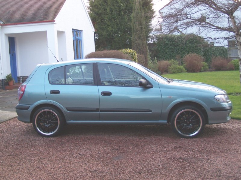

Just got new discs and pads fitted and a 30mm drop courtesy of Eibach 'Pro' springs.
Before and After (click to enlarge)..
It's not a hugely obvious drop in the pics but is definately subtly noticeable in person. I guess the springs also have to settle a bit, though.
The handling is so much better, not much roll at all now. Not too harsh either except on really rough roads. Well worth the £££s.
Painted my calipers a couple of weeks ago too..
Next things on the list are a custom cat-back and a tidy-up of all the chips and scratches in the paintwork. After that I'll see what can be done to the engine.
It's more obvious in the enlarged pics.
With a couple of people in the car it drops a few centemeters more (till the rear wheels are flush with the arches) but it's only a 30mm drop anyway; I'd have gone for the 45mm Sport springs but need to be able to stuff the car with people and camping kit without it bottoming-out and the roads I drive are infested with speed bumps anyway. Slamming a six-year-old 1.5 N16 to the ground would probably look silly in any case so I'm trying to be a bit more subtle.
The old springs were 6 years so are likely to have sagged a little and the new ones have just been fitted so need to settle (I guess).

I wimped-out and got my local garage to do it along with my discs and pads and replacing the slightly rusted rear brake piping all at the same time. I got them to check tracking and alignment afterwards too (it needs done when changing to lower springs).
I could have done a lot of it myself but don't have time to faff about and so many bolts are seized-up on my 6-year-old car I thought I'd let them loosen everything off for me :)
