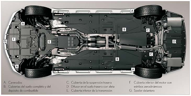

thx for the answer, but isnt it easier to do a flat bottom (sorry i dont know the exact term in english) something like this (parts B and D)
here in trackdays the potenza re002 are being quite common and they are not too expensive. Havent tried them yet but heard good comments on them from heavier cars
More effective yes, easier no. I do plan to do this but to do it properly is not all that easy. You need to use a pretty rigid material and obviously it has to be as light as possible. Ideally it needs to cover the whole bottom of the car so you need to figure out how to let the heat from the exhaust escape. If I've time I might start experimenting with something over the winter.
