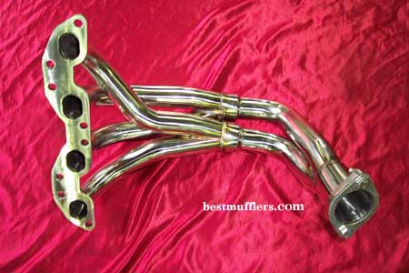

search tri-y header on the dash, i think it show'd 10whp over a 2.5' SSAC header. key is to swap the pairing to that like the ASP instead of everything else.
lonewolf on SR20 forums advise the x-force is as good as the ASP budget header. google x-force headers.
david
Tri-Y headers like Honda´s eBay heade or ASP budget header has same ground clearence problems like 4-1 header.
Xforce Header N15 SR20 fitment and stepped too :) Who sells them & how much though?... Rich has emailed them direct so curious to see what other info they can provide themselfs!
Available in Stainless Steel
DESIGN
TRY/Y
Primary42mm
Second 45mm
Outlet.. 57mm
Vs Ebay/SSAC/Toyosports (Hotshot ripoff/replica) Header *Without modification mind...
Primaries 53.125
Secondaries 46.875
Outlet 62.5
Can't see find any reviews on the X-force as of yet...Dave?
Mentions custom, I assume that's because it will need a downpipe made up as it doesn't come with one pictured?
Doesn't look long enough to come all the way to the cat from the picture though does it? Its going to need custom in-between pipe made up isn't it akin to a downpipe.

Dear Customer,
Thank you for your inquiry.
Price is AU$400, plus freight via Fedex(excl. of custom duties and taxes) is AU$100.
----- Total: AU$500.00
Payment methods are either direct bank transfer or paypal ([email protected]).
Please be advised that it is not direct bolt-on to the factory cat because it is longer than the factory stock header, it will need custom works for the cat parts.(Most of our customers will custom fit the after-market cat).
Also please careful check the specs to make sure it will fit the UK version.
