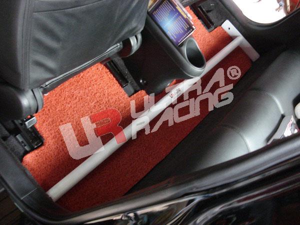

I got the front strut brace yestoday. I will go to the main factory and order from them next time.
I will also get
Sentra N16 16mm Rear Anti Roll Bar
Sentra N16 Front Lower Bar
Sentra N16 Room Bar
I may get the rear strut brace as well
I was wondering if any one can confirm that the white line N16 Rear Anti Roll Bar will fit a N16 Hatch. if the white line one will fit I will order the Ultra Racing one.
Darren
Wow. Going to be one serious mother fucking track bitch this.
Dog III eat your heart out.
Sorry Darren - if that bar had been halfway (or even a 1/3) up the B pillar, then I could see it making a difference to stuctural flex. But that low down, I bet you wouldn't feel any difference at all. But each to their own . . . .
Not buying it all would be cheaper imo. Like Paul says, each to their own.
