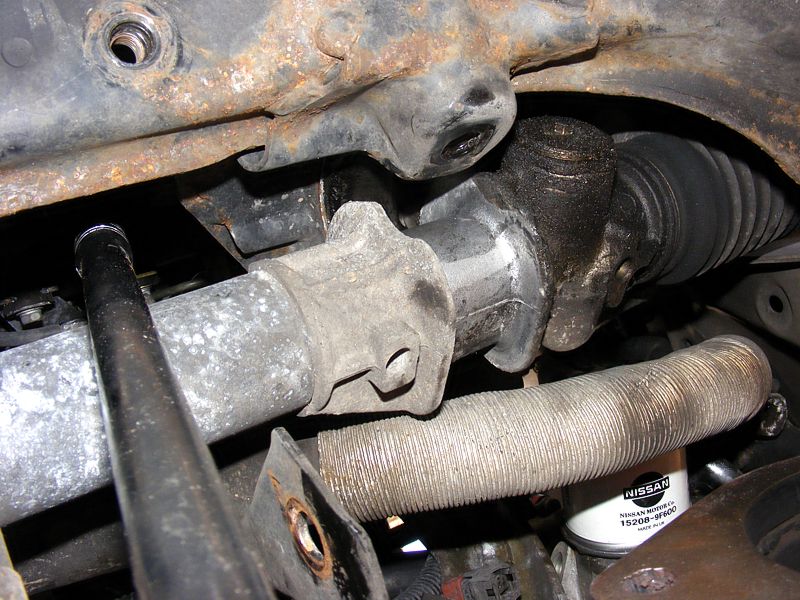

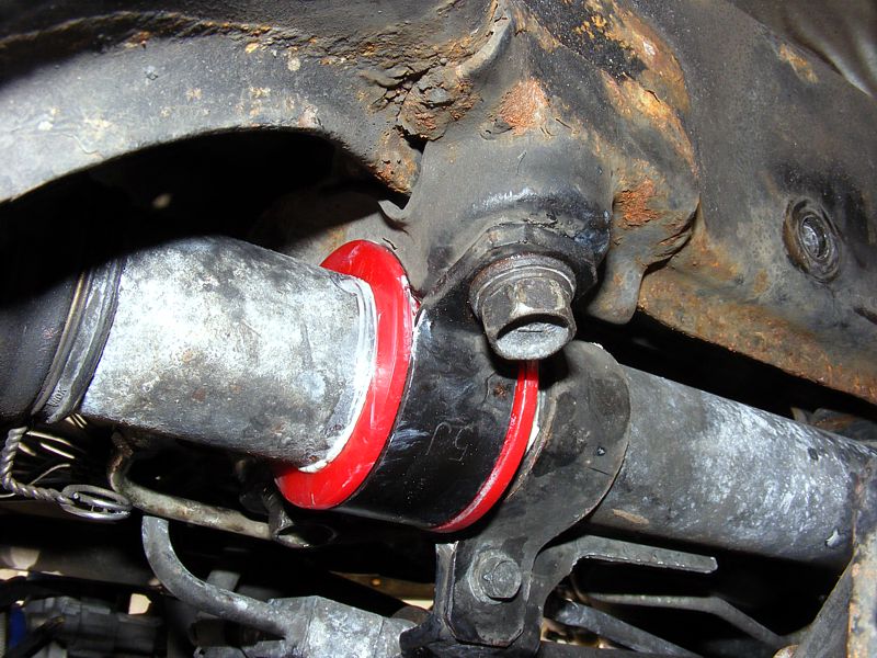

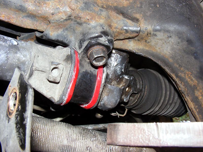

was time to replace the steering rack bushes today, cheers for the tips guys,
was pretty straight forward swapping them.
new ones in place.

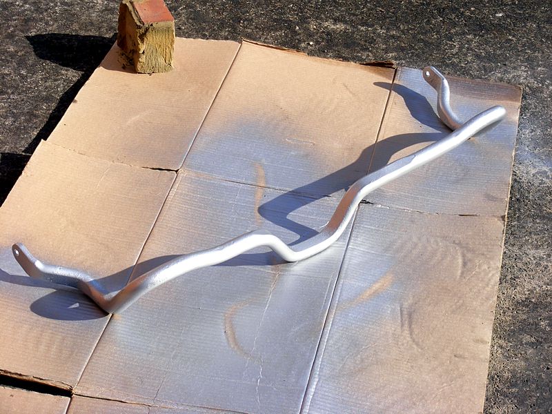

also removed ARB, got it all wirebrushed, as it wasn't looking good, will get that painted up tomorrow...

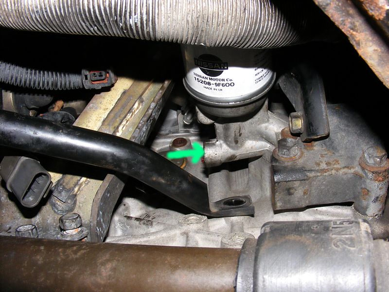

how the bugger do you remove the oil pressure switch off, can't see a spanner working on there, need to remove it, looks like it has been removed in the past as there looks like some sorta orange sealer on the thread part that is sticking out...
its covered in oil, so need to remove and replace it...

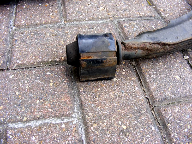

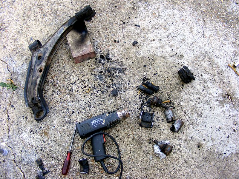

though didn't go full on mad with fire, just use the heat gun to get the rubber hot enough
to twist the "D" shape mount off the wishbone...that is after the main housing was cut off
with grinder.

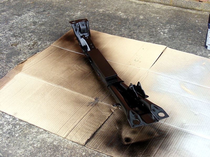

ready for some wirebrushing

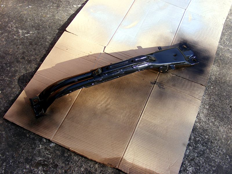

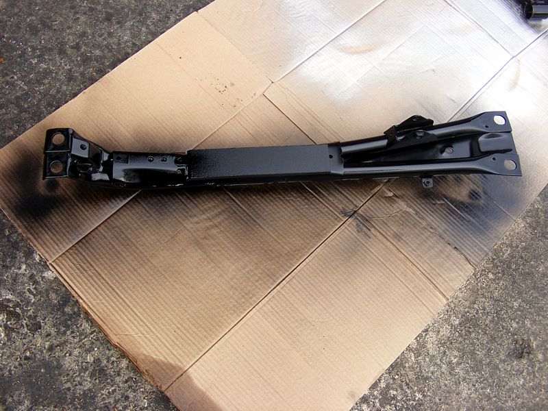

cross member and arb were both wirebrushed, and now painted up with some
hammerite..

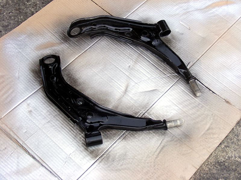

first coat of hammerite on the wishbones.

Do you just clean back with wire brush then paint on hammermite or is there more to it?

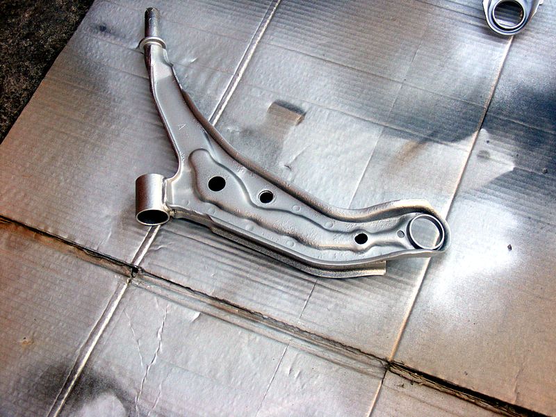

yeah just wirebrushed any loose rust and crap, degreased em and painted up...didn't bother with any extra stuff for em, will leave that to the bodywork on the car...

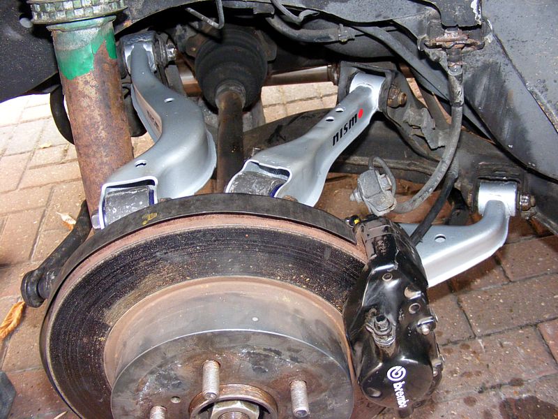

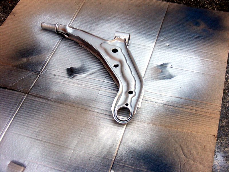

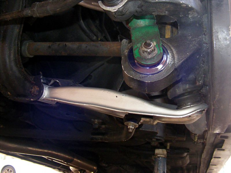

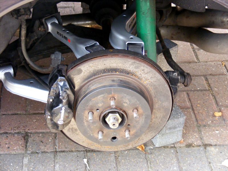

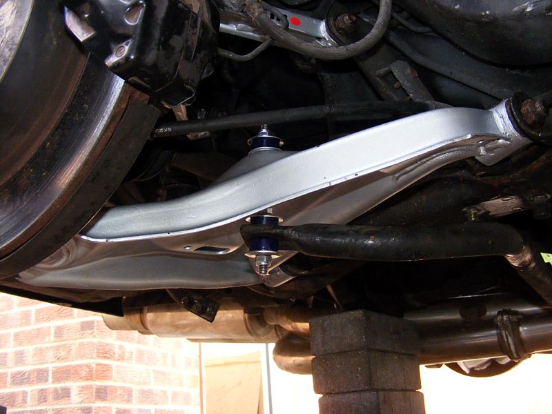

was thinking of doing the wishbones Silver, like I did on my Skyline for the suspension arms on the rear..
they were genuine Nismo arms, but were 2nd hand, so cleaned em up and repainted silver as they came in silver

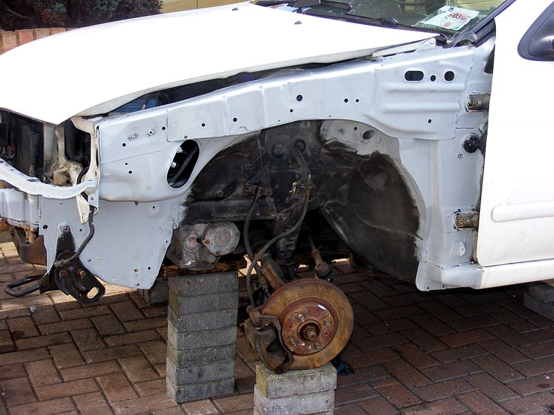

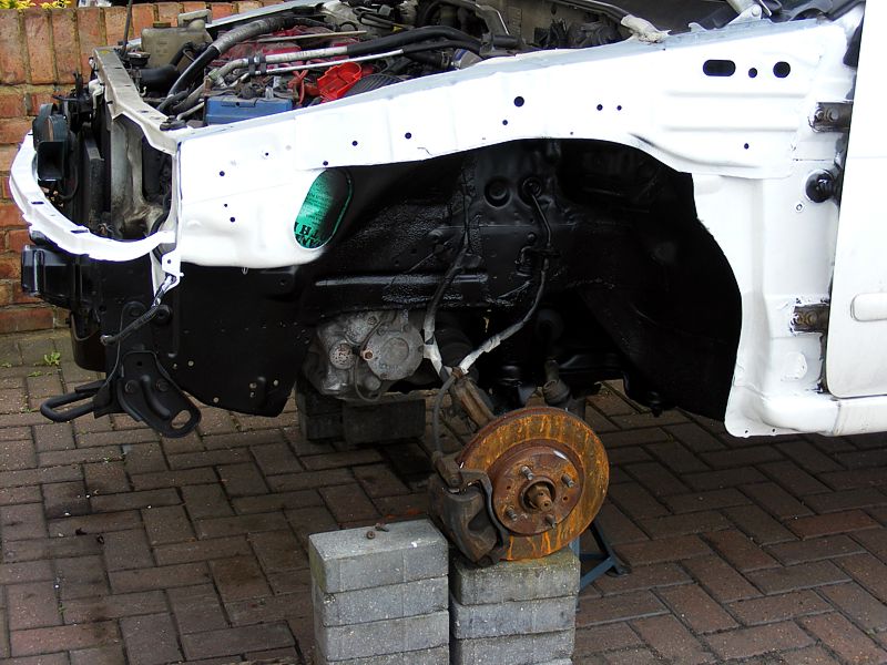

update for last two days..

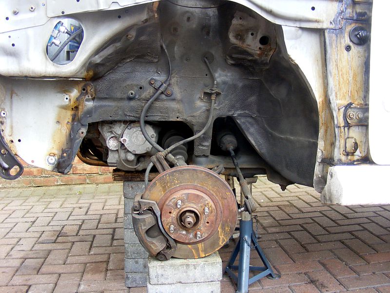

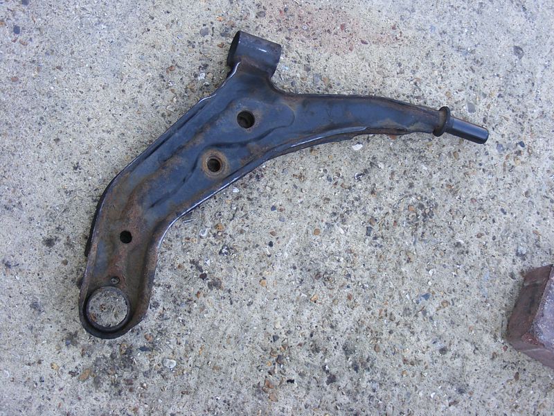

Wishbones removed, was pretty straight forward removing them, apart from
the two lower bolts passenger side shock, being totally seized in, was a pita to remove them,
then on the other side, split pin in the ball joint was a right bitch to remove as it
was in at an awkward angle..

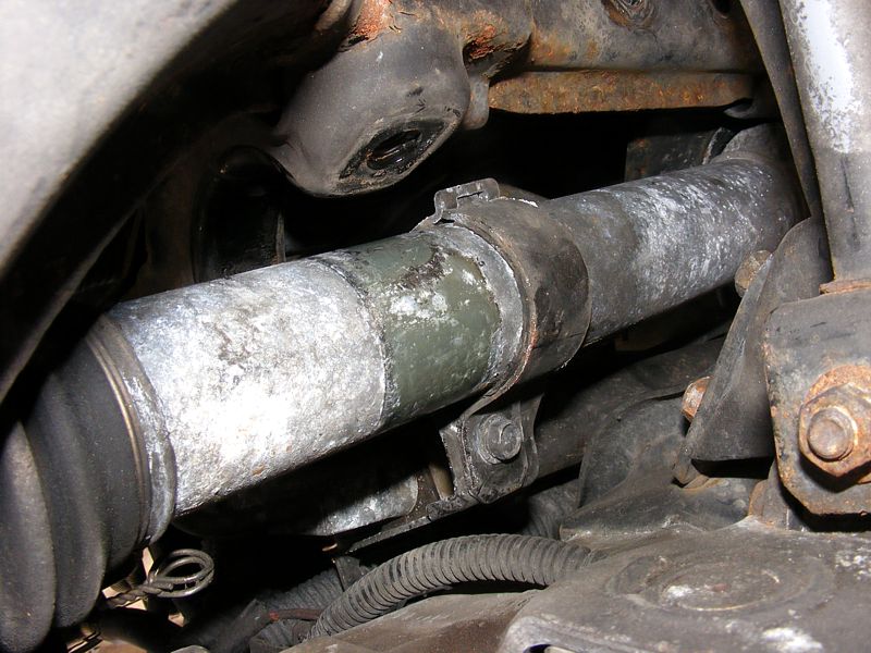

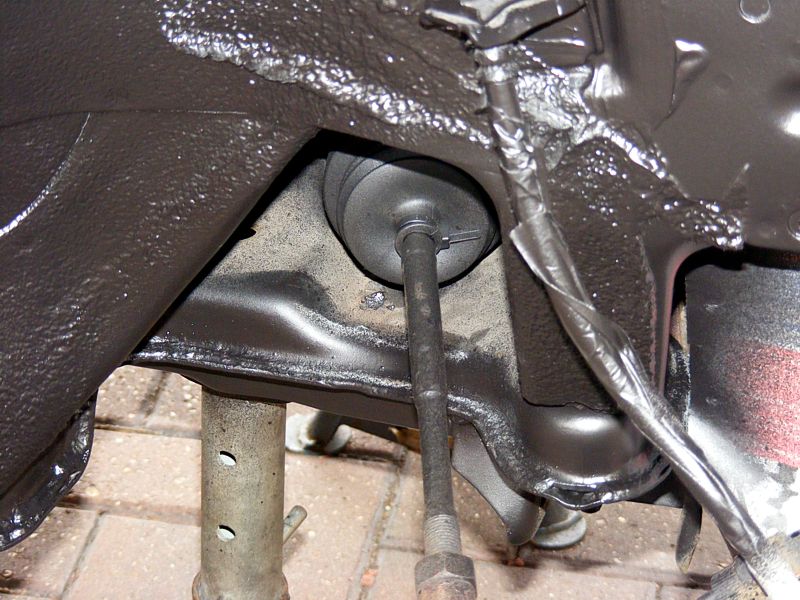

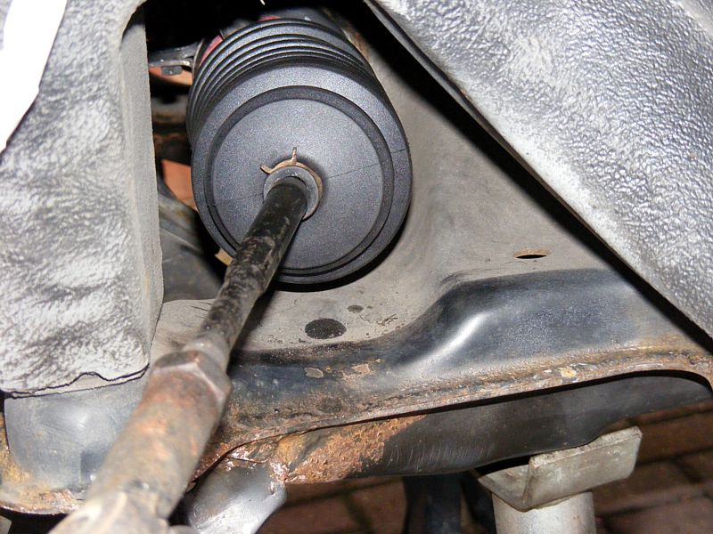

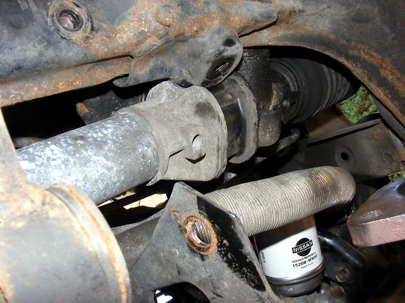

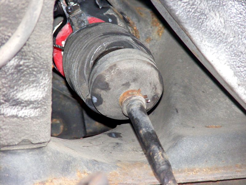

when removing wishbones, noticed steering rack gaitors split both side :(
also noticed this bush on mine are totally different to the spare set I got of Wezz's N1..

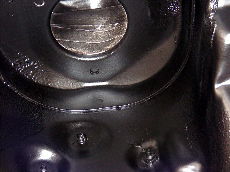

first coat of Galvafroid anti crossive paint put down...
nearly finished painting them...
now stuck on how to remove tie rod ends, to change steering rack gaitors, and also to find replacement tie rod ends and drop links, as ones I've seen for GTIs don't seem to be the same as ones on N1...

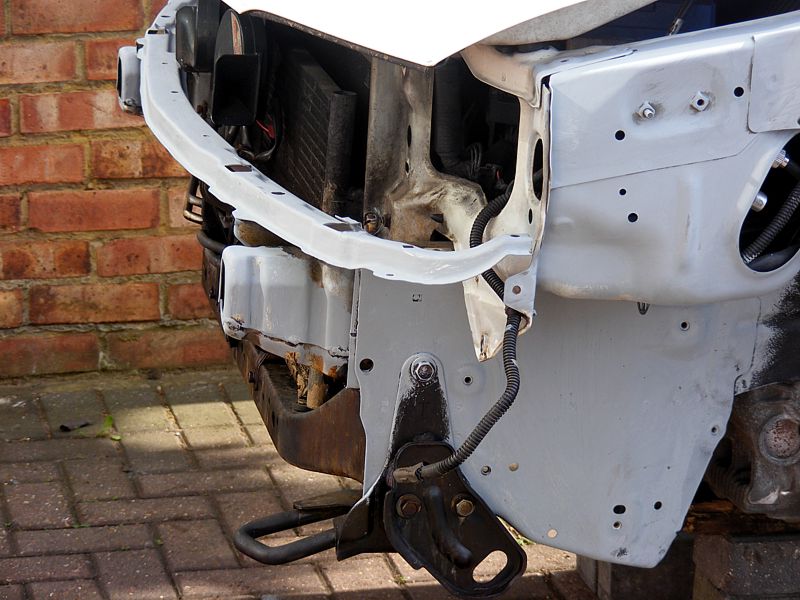

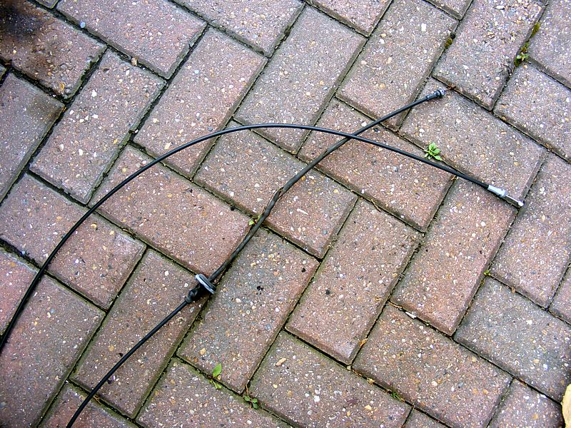

old bonnet release cable and new one..

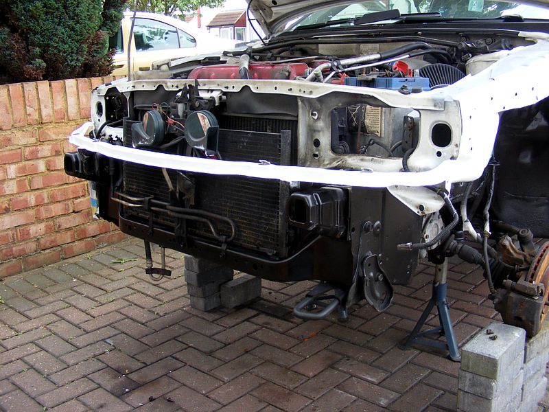

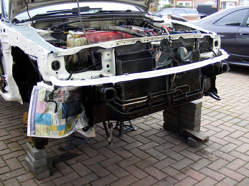

painting started...
new steering rack gaitors fitted
spent over half a day, trying to remove one poxy oil pressure switch...gonna be fun
putting the new one in, once I get some loctite..

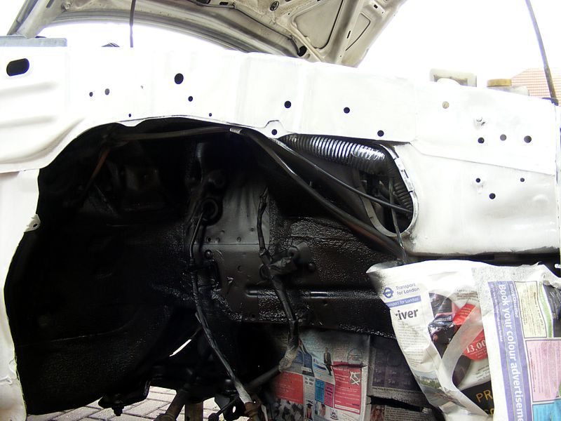

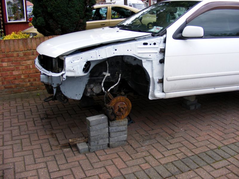

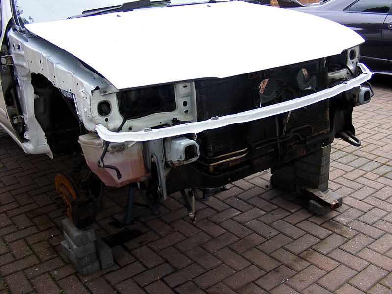

2nd coat of white done, and stonechip guard done under the arches
