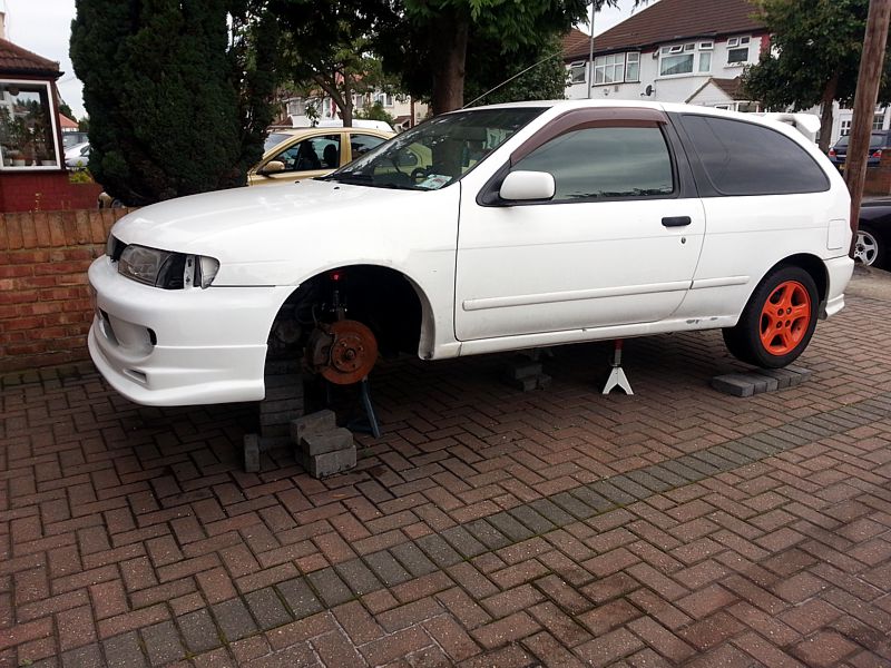

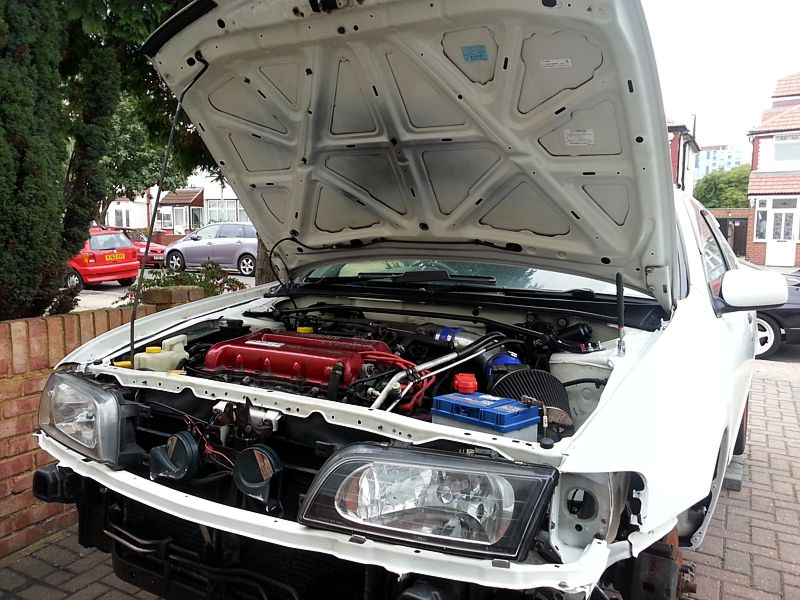

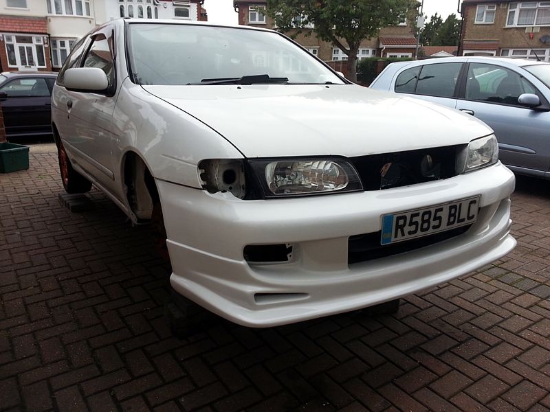

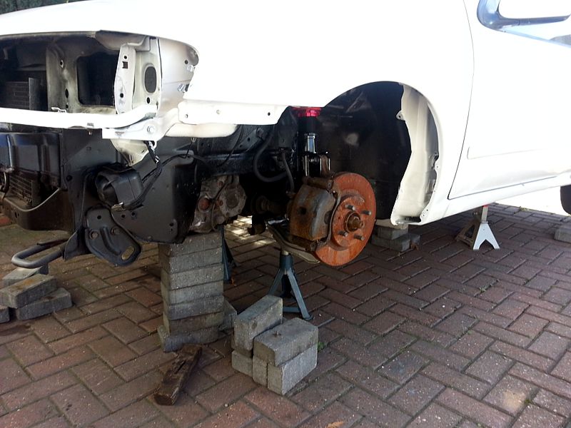

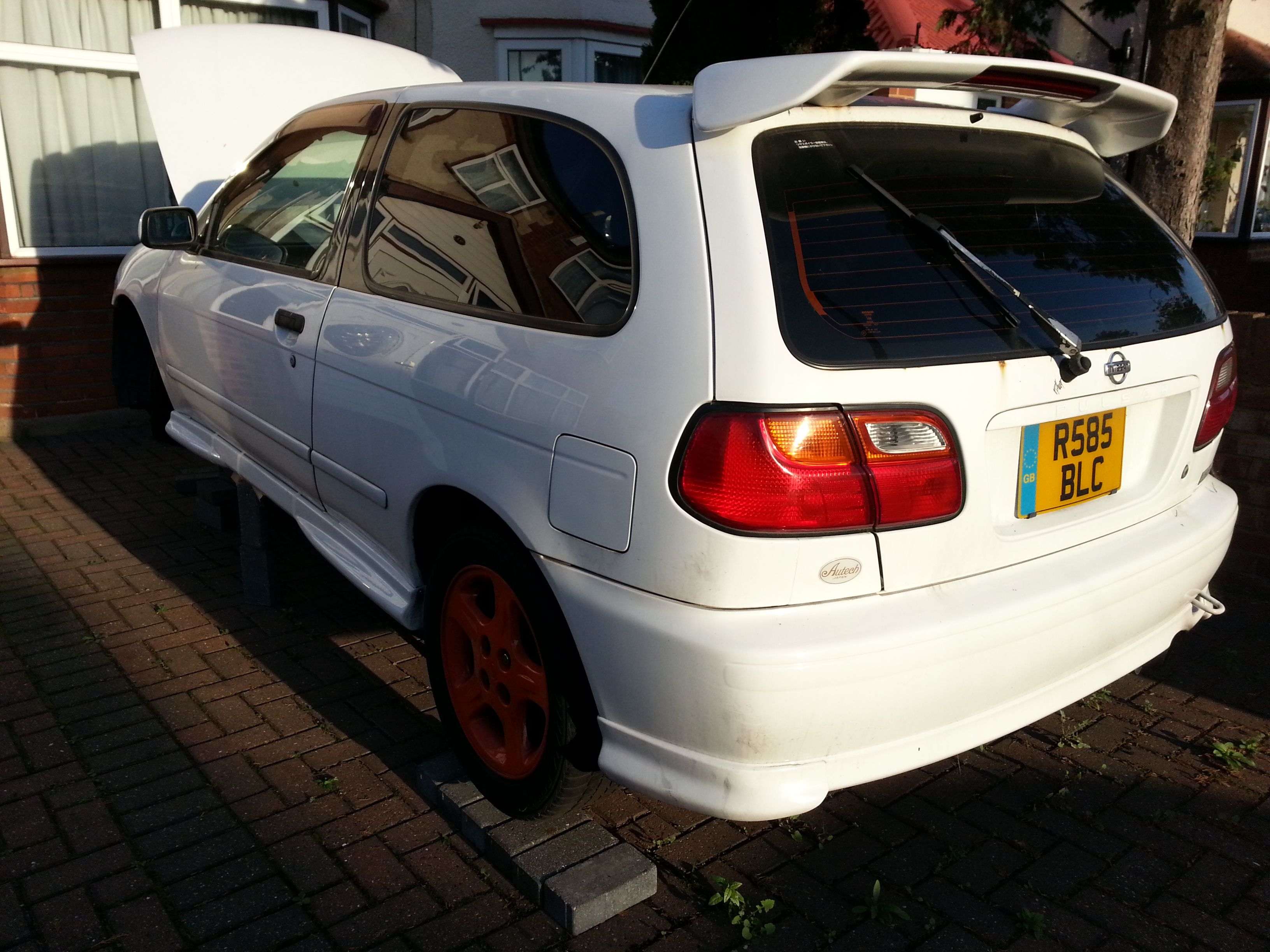

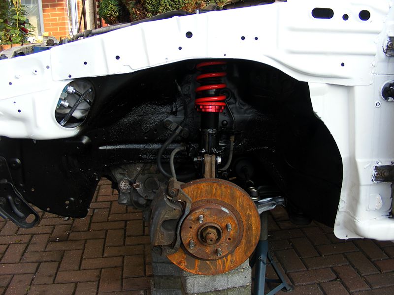

finally got some more work done, what with the crap weather and weekend taken up by other things, haven't had much time to play cars...

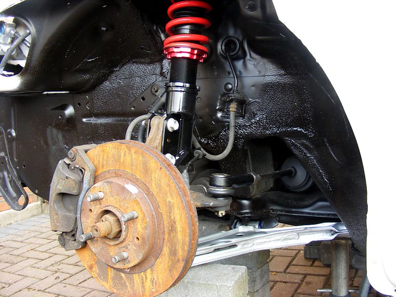

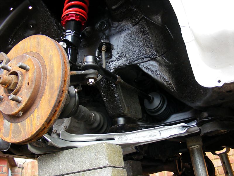

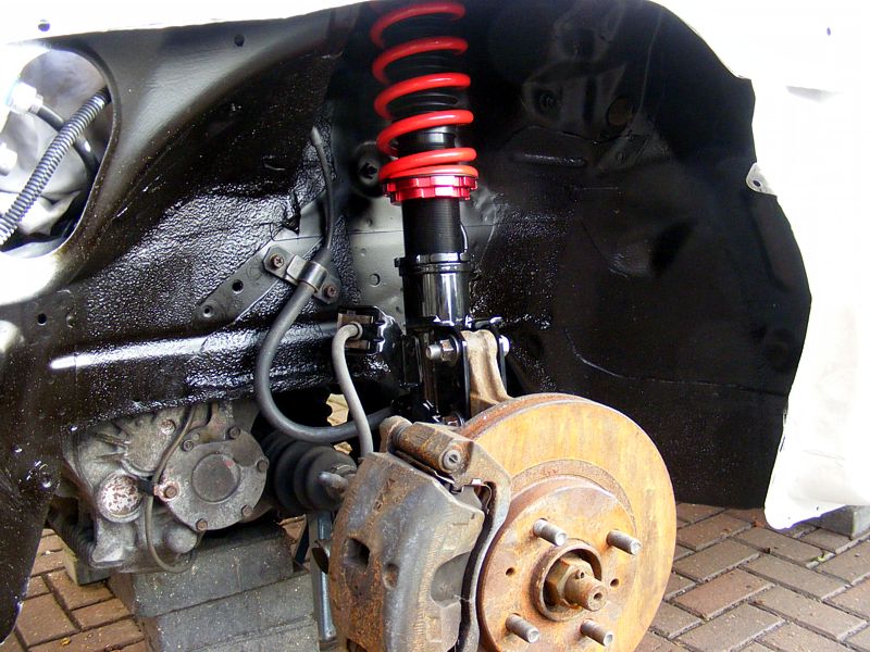

most of the painting done now, starting to fit stuff back...got the new oil pressure switch back on as well...
I'll have to give the brake discs a nice wire brushing when I'm ready to get the wheels back on

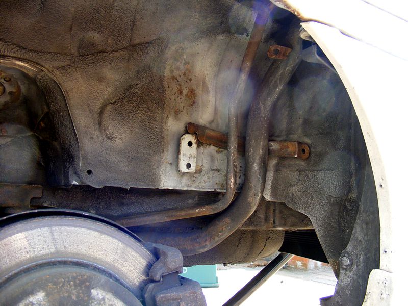

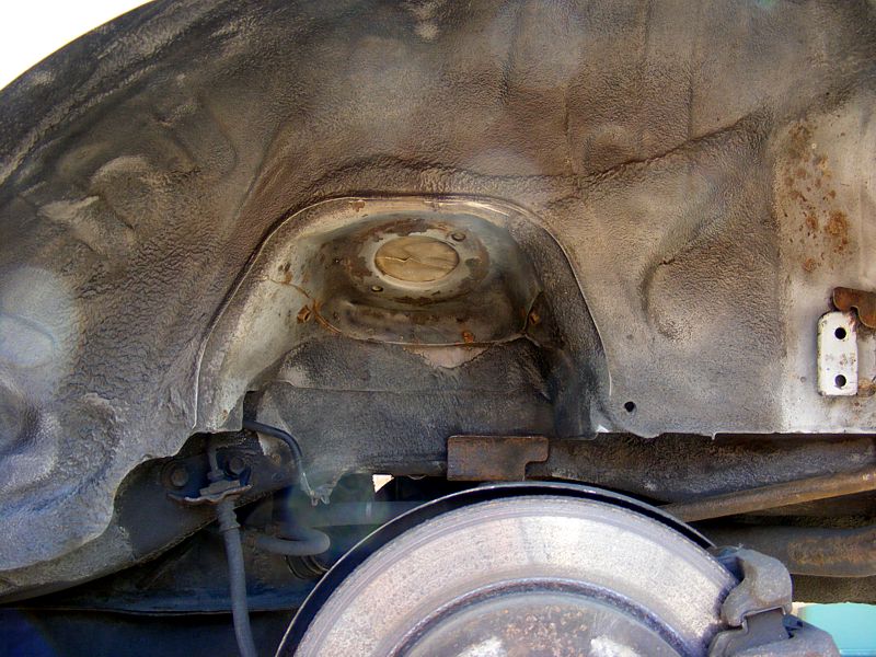

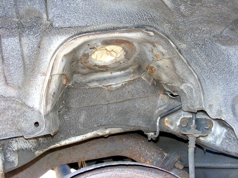

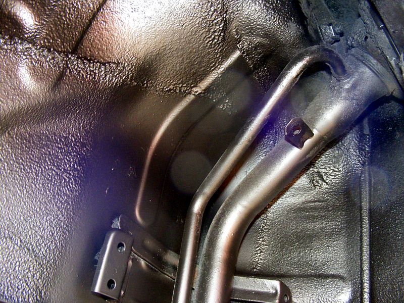

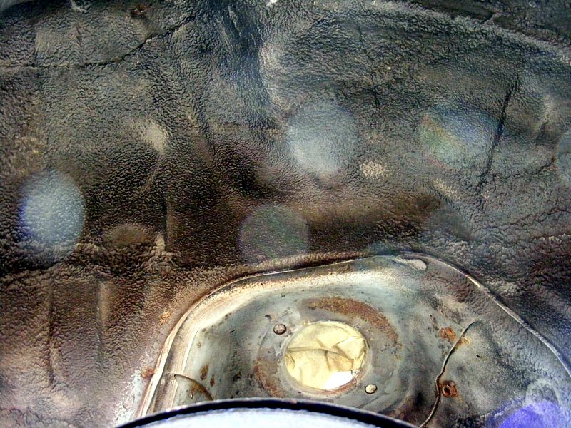

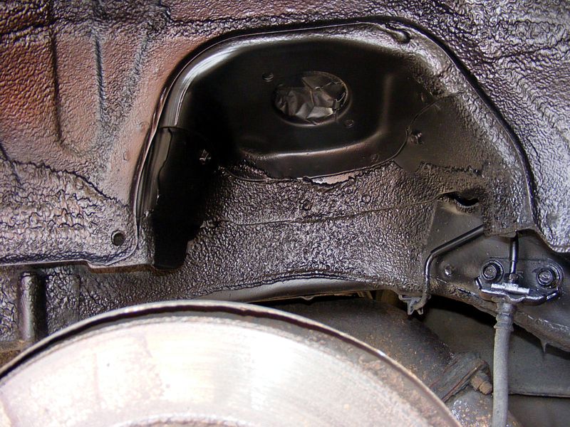

Not sure if it's been mentioned but what sort of underseal are you using inside the wheel arches?
Sent from my GT-I9100 using Tapatalk 2

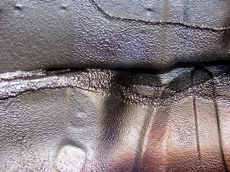

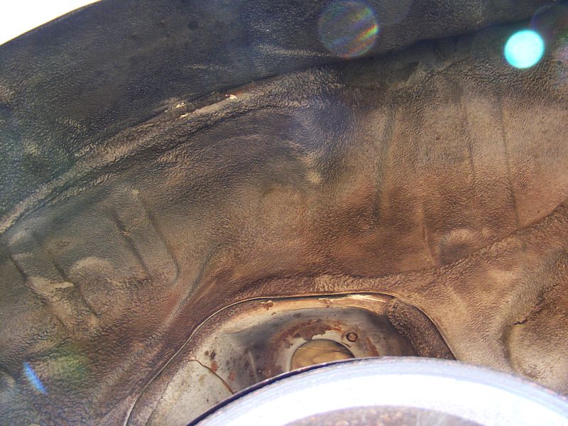

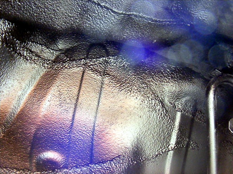

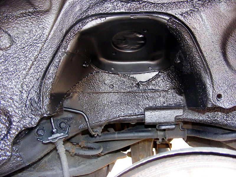

first a couple of coats for 3M stone chip paint, once that was set, covered it with a couple of coats of Bilt Hamber Dynax S-50 Extreme Duty Anti-Corrosion wax, which sets to a slightly tacky finish...

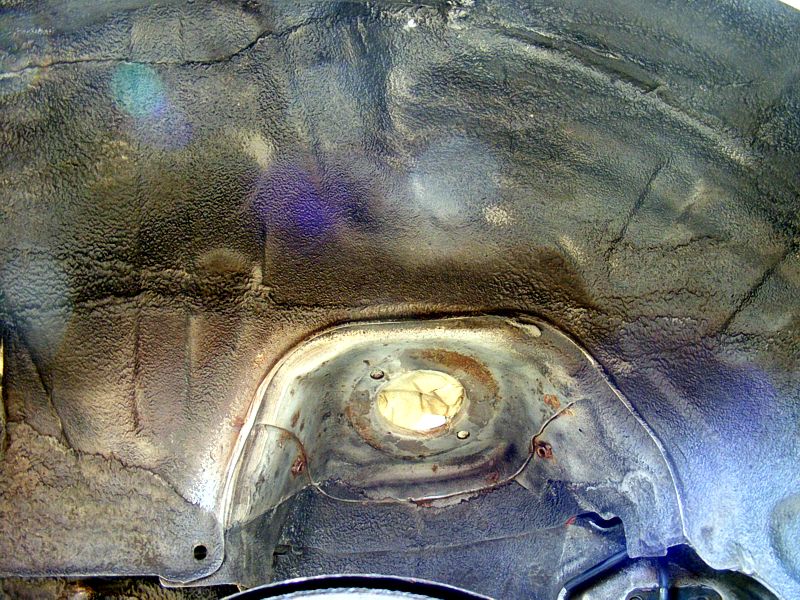

That crease needs filling in or welding over. I didn't want to weld over mine so i've filled it with a special fiberglass material and smeared heavy duty sealant over that and then regular body sealant over that before covering in stone chip.

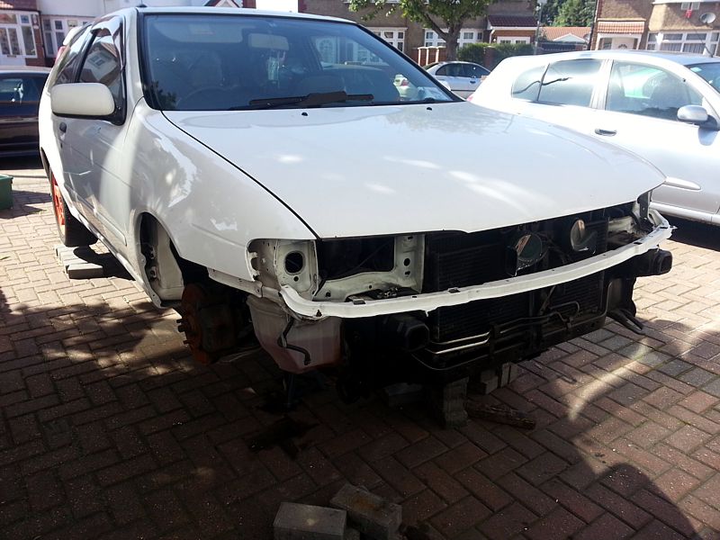

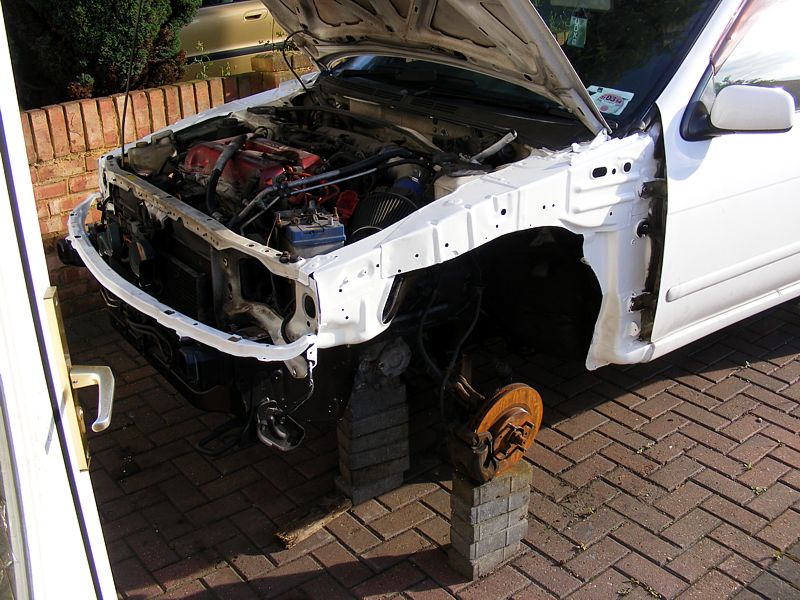

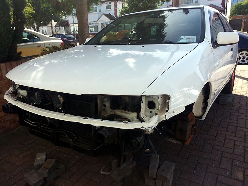

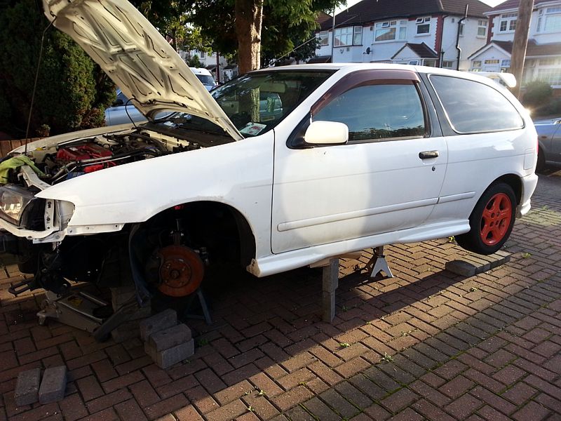

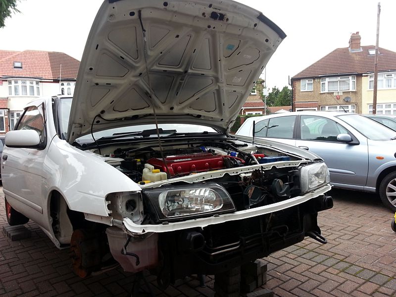

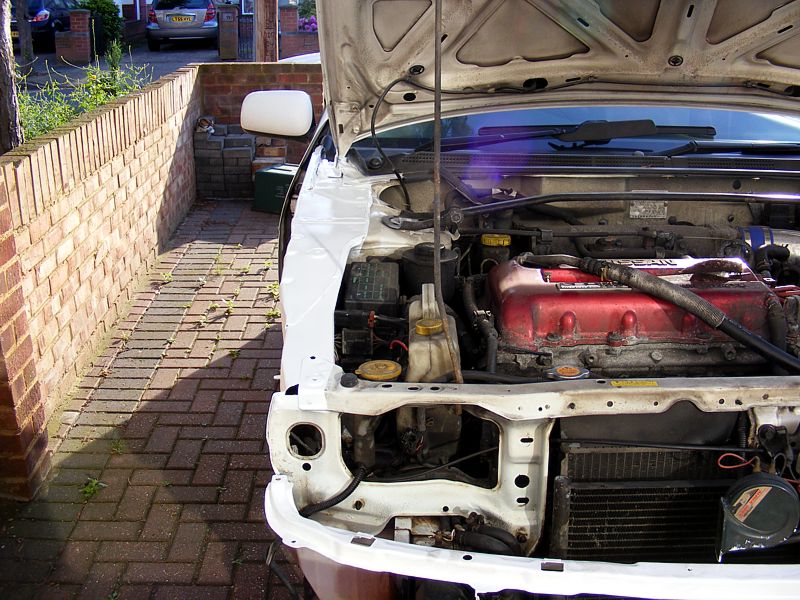

time for some more updates, things been a bit slow, but getting there...
wings back on..

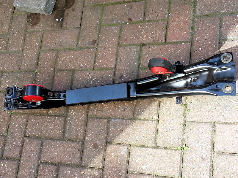

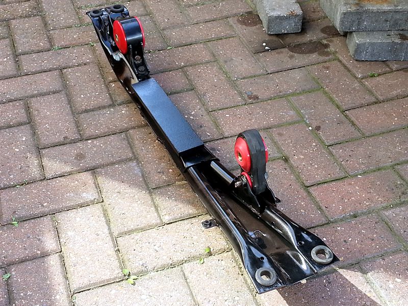

cross member ready to go on, ...
