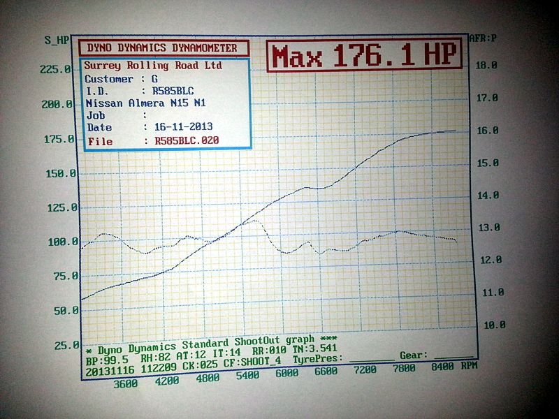

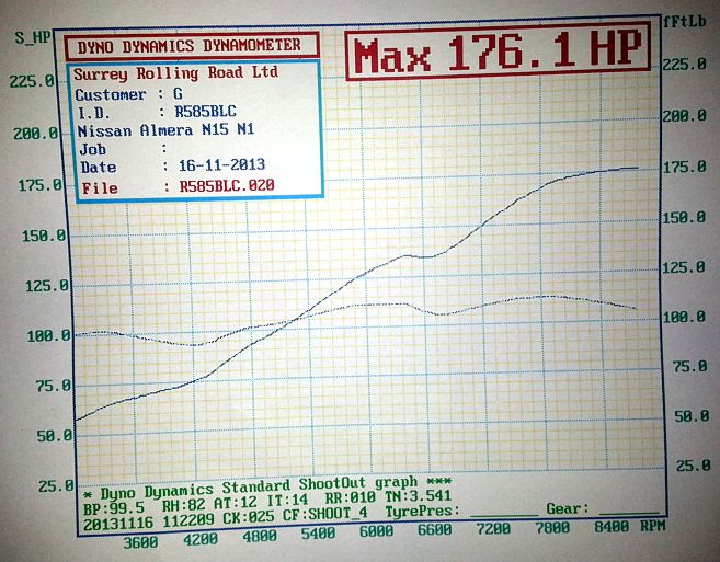

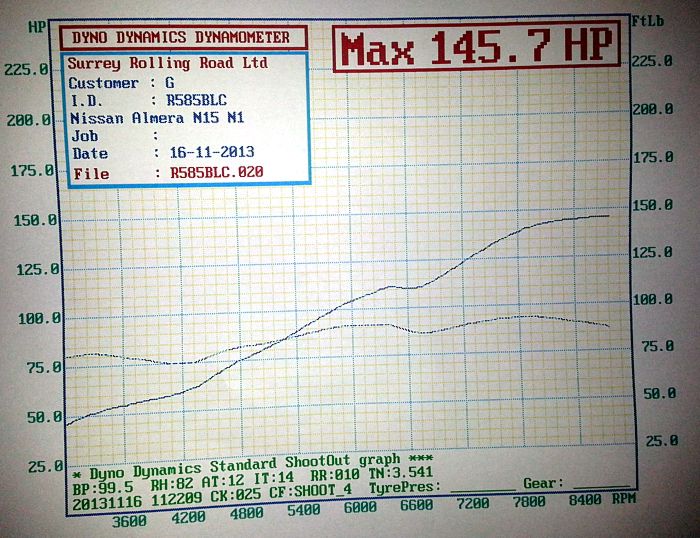

graphs after today's run...
looks more like it.
So was this another different dyno again? Serious diff in number there if it was just 2 different dynos.
yeah this was different dyno, where I've done previous runs as well, so any change mods I do, no matter what result I get at another dyno, I don't pay much attention to, just stick with this one, so at least all changes are checked and measured at the same place...
Looks like it holds the power well, maybe still climbing at the rev cut? 8700rpm on the graph.
if you at the graph on the previous page, at H-Dev, that shows it cutting out at 9200 ish, that run I mentioned above where I had it at an indicated 9kprm on the car, it was still going strong, could have left for a bit more, but didn't fancy hitting the rev limiter lol
